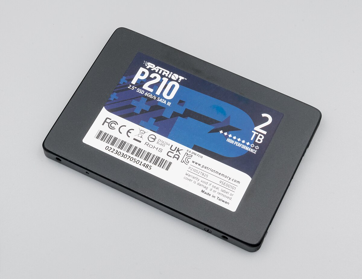

Wow! What dose SSD stand for?
Solid State Drive
A solid-state drive (SSD) is a solid-state storage device that uses integrated circuit assemblies to store data persistently, typically using flash memory, and functioning as secondary storage in the hierarchy of computer storage. It is also sometimes called a solid-state device or a solid-state disk, even though SSDs lack the physical spinning disks and movable read–write heads used in hard disk drives (HDDs) and floppy disks.
Reference:
Reference:
Exactly. So what's your point? The router doesn't have an SSD. As the wiki entry says, they were sometimes called a solid-state disk (although I don't believe that was ever an official term) because they were drop in replacements for HDDs and emulated the form factor, interface, geometry and control commands of a HDD. None of those characteristics apply the the router's flash memory.
Just because an SSD contains flash memory doesn't mean that all flash memory is an SSD.
At the end of the day if you want to use the terms disk, drive, flash and nvram interchangeably that's up to you. But to me they mean distinctly different things.
