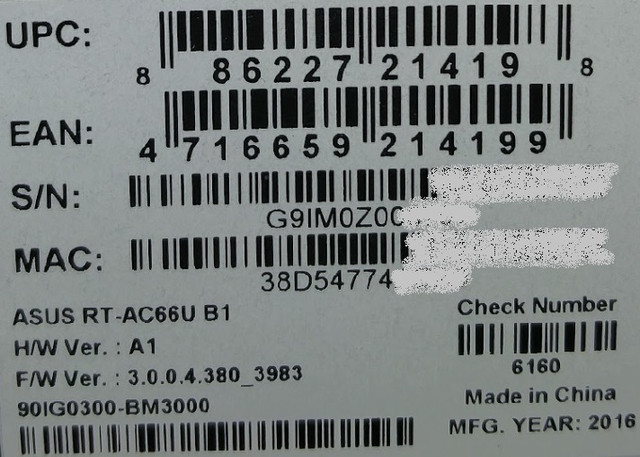

I can confirm that AC68U Kille72/Shibby Tomato firmware will not boot up on RT-AC66U B1 hw ver A1. According to leds it tries to boot up, but then ~1min into bootup crashes and reboots.
Nevertheless, Merlins AC68U firmware boots up fine on this 2x1000mhz AC66U_B1_A1.

Indeed, I tried doing the exact same thing you did last night, except that I tried flashing the Advanced Tomato firmware instead of Shibby Tomato. I think if you read further, you'll notice that the Tomato firmware for AC68U cannot be loaded on newer revisions of the AC AC68U such as the C1, which has a similar CPU to the one the AC66U_B1. If you're thinking Shibby is going to support C1, then forget it. So, we're basically limited to Merlin's firmware and DD-WRT.
I actually placed an order from for the AC66U simply because I wanted a router that has many third-party options. Instead, they sent me AC66U_B1 (H/W ver B1). I considered returning it, but decided to keep it as it was slightly more capable machine and also supported Asus Merlin.
I would just like to know from Merlin why the Asus firmware for the AC68U worked on the AC66U_B1, whereas Tomato firmware that works on the AC68U doesn't work on AC66U_B1. It's like saying, a = b and b = c, but a ≠ c.
Because Asus uses an upgraded SDK that supports the new hardware revision - Tomato's SDK is too old.
