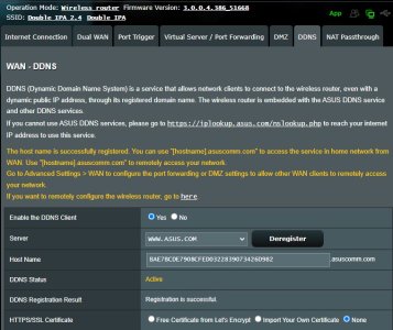

Hmmm, yes, it looks like the DNS is from ASUS.com. do you think changing my DNS to my ISP's would help? How do you get a DNS from your ISP? Sorry, I am barely qualified to be having this conversation LOL. Also, yes i'm going through my primary. The Imesh node is pretty far away. The only reason I'm using it is because when I walk across the street it will switch over instead of weak signal and having to switch WiFi

The DNS settings is something else than DDNS.
Have a look in: Advanced Settngs > WAN > Internet Connection
Look for this part:
Only "OK" will not change anything.
You might go back to the DNS settings and select "Google" followed by "OK" and test this for some time:
