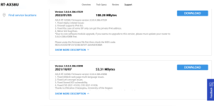

It looks like you need to flash the build from October before you can flash the build from January -
'*Due to core software module upgrade, if you wanna to upgrade to this version, please must update your router to 3.0.0.4.386.45898 first.'
