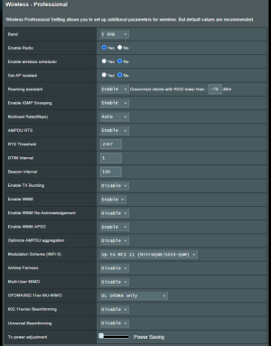

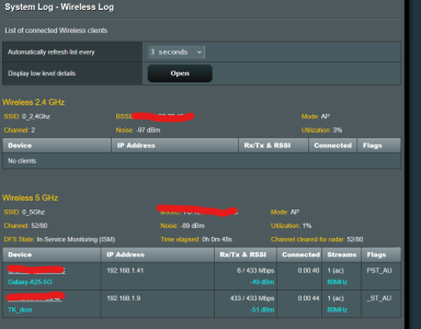

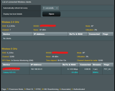

What can do speed up?
Impossible to tell without additional information about settings and client link speeds. Look at your Wireless Log.
