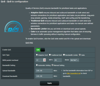

Hello, It has been obsrved that the CAKE-QoS is not working on the Asus RT-AX58U_v2. Also, in the Hardware Acceleration, only Flow Cache gets Disabled and "ARCHER" stays ON when CAKE is turned ON.
This issue was there in the latest stable build 3004.388.9_2-gnuton2 and is being carried forward to the alpha build 3004.388.10_0-gnuton0_alpha3.
Right now I am on the alpha 3 build and have already mentioned the same on the feedback but I'd like some help on finding out where the issue lies in order to get this fixed.

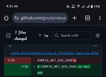

At the end of issue#615, the problem appeared to be RT-AX58U V2 requiring RTCONFIG_HND_ROUTER_AX_6756 which I believe is the CPU of this model but i am not sure how to verify if this is the same issue which has reappeared or something else has gone wrong.

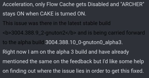

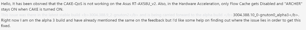

Found the problem @ColinTaylor
I was using my system dark theme so it was not visible to me but was visible to those with light theme. I think I will need to use this forum on Light theme when I post or comment.
Now when I used light theme to fix it it appears black on dark theme.
Dark theme:
Have to be careful with all themes.

Here's the result of the following codes:
/tmp/home/root# tc qdisc add dev ppp0 r
oot cake diffserv3 bandwidth 102400kbit overhead 42 mpu
84 nat dual-srchost
RTNETLINK answers: No such file or directory
/tmp/home/root# tc filter add dev ppp0
parent ffff: prio 10 matchall action mirred egress redir
ect dev ifb4ppp0
RTNETLINK answers: File exists
We have an error talking to the kernel
Forgive the ups and downs in the code. Using Termux from Android device for ssh.
