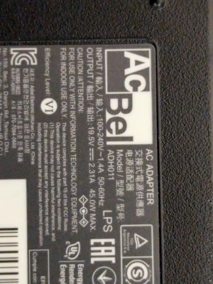

ASUS PS specs 19.5V 2.31A 45W MAX
could i post amazon links?
will this PS work?
Just saw you posted a picture of your current PS, which is good as there are two different ones apparently…obviously if you can get the ACBEL compatibility will be more likely but that one could work, I can’t guarantee it and the site says often returned.
I’m not sure how it determines the 19.5V but Amps is fine and the M5 and M19 connectors seem to match one of the two options as noted on one of these threads. A 33W with 4.0mm * 1.35mm connector and a 45W with a 5.5mm * 2.5mm connector. Suggests your connector plug is 5.5mm x 2.5mm, so M5 in that Amazon link.
