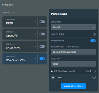

Make sure you have Access Intranet enabled when using VPN Server if you want to access your local LAN.

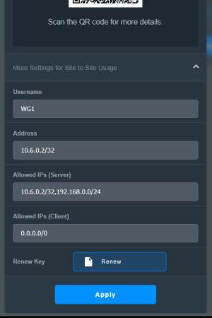

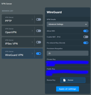

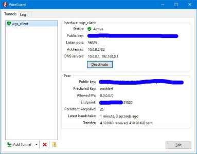

Today I read a bit more about it and put it all together. And it worked. I configured Wireguard on Asus RT-AX86U_Pro and I can see the entire home network behind the router via VPN. The router's IP address is 192.168.0.1
Below are screenshots of the settings. Tested on Windows 10 and Android 14 - it works!
One note: devices reachable by IP, does not resolve the host name, but that's irrelevant to me.
