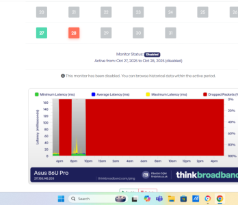

I'm trying to sort out bufferbloat / packet loss issues with the current merlin release, what I'm finding out is that it is timing out every so often. I have enabled ICMP requests but still am having issues. I'm not very technical so would like some help as to what is causing this issue. I have attached a file so you can all see.

According to that chart your router was offline for the last 19 hours. Prior to that it was online for two hours and looked fine with no appreciable packet loss.
See the thing is the router wasn't offline at all which is very strange as it's very intermittent
Then I'd say that your ISP is having issues and/or the IP address you're monitoring has changed.
What does today's chart look like?
Log into the router and check the WAN IP address shown at the top of the Network Map page is the same as the one you're monitoring.

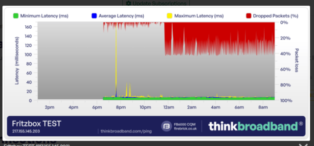

Fritzbox Test BQM
Thanks. That looks the same as what I was seeing. Packets being dropped on a regular period, but otherwise it looking good.
Show that to zen (now that you're using their Fritzbox) and ask them if they think that is acceptable.
