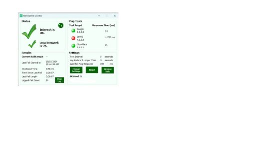

Thanks for the response. I've looked at the log, and I'm not seeing any events that show a connection failure. However, I am running Net Uptime Monitor, and it is failing every few minutes, and activity keeps pausing every few minutes. As noted in the JPEG, I've had 24 failures in 56 minutes.
If there's nothing in the log that suggests the problem is upstream of the router. I know you said that the problem didn't happen when you plugged your PC into the modem so it maybe some sort of provisioning issue on the ISP side.

Absolutely no indication from what I can see as to why it's being dropped, just keeps saying WAN was restored.
I believe the issue started when I did an update as well because it worked well for like 2 months and then for past month this constant internet connection drop keeps happening, I just yesterday saw a newer firmware (the one from end of September) and installed it hoping it would fix it, at first it seemed it did but then I wake up to see those logs and those WAN restored messages again this morning.
FYI, I have a Nighthawk Cm3000 as my modem.
