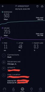

It's been a while, but I was able to finally verify that my setup/connection is working correctly. All I had to do was to run Speedtest simultaneously on two separate devices; I ran the Speedtest app on the LAN connected HTPC and my Samsung Note 20 Ultra 5ghz WiFi connection, sure enough, I ended up with a total of roughly 1,406 mbps down and 46 mbps up.
HTPC
Phone
Works, I just won't ever see the speed on one particular device at any time. The only way I think I would be able to is by getting a dual 1Gbps ethernet port LAN card that supports Link Aggregation, and then set up the LAN bonding option that my router has.
So, if anyone wants to know, the SB8200 w/LAG enabled + Comcast 1.2Gbps tier + Asus RT-AX88U w/ WAN Aggregation enabled, will give you the speed you're supposed to have, you just won't see it on any Speedtest or see one particular device utilizing that speed to its max.
