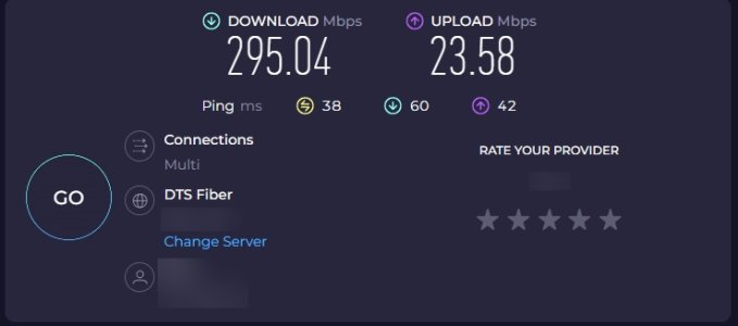

I have a desktop computer with a wireless adapter. For testing, it is the only device connected to my Wi-Fi network and the only hardwired equipment are the WAP and cable modem.
Network Topology
  • Arris Surfboard SB8200 – Connected to ISP at 1 Gbps
  • Unifi Dream Machine (UDM) Special Edition (SE) - Running iperf3 server
  • U6-LR WAP connect to UDM SE via 1GB ethernet
  • Intel(R) Wi-Fi 6E AX210 160MHz - Windows Desktop Computer
An internet speed test to speedtest.net yields me an average of 295 Mbps from my desktop computer. However, when I perform an internal LAN speed test with iperf3 I get 145 Mbps on average. I would expect the internal LAN test would be just as fast if not a wee bit faster than the internet test. I am desperate for an answer and hope one of our geniuses out there can explain to me what is going on.
I should mention the LAN test running on a Linux OS yields 188 Mbps, which I can understand why is faster than Windows but still not as fast as the internet test.
Screen shots attached. Thank you in advance.

I'd be more concerned why you're only getting 1/3 of the plan speed. If you bypass the router and connect to the modem directly what speeds do you get?
I didn't mention speed tests directly from my UDM SE to the ISP as that's not my concern. I do get anywhere from 800 Mbps to 950 Mbps depending upon the time of day as expected for a cable service. The issue I'm concerned about is that I'm not getting even close to 1,000 Mbps internally. That is why I setup iPerf3 to figure out how fast my actual WiFi connection is, because I knew I should be getting closer to a gigabit. I was shocked to see the speedtest.net results were faster than the iperf3 results. Maybe iperf3 isn't what I should be using to test? And before someone asks, I'm practically sitting on top of the WAP and have an excellent connection (-52dBm).
