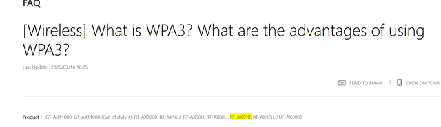

One missing feature that should be there but isn't is WPA3 support. There is a FAQ in the Asus AX89x support site with instructions to enable WPA3 and the AX89x is listed in that FAQ as supporting WPA3 - see image below - but it's absent from the most current firmware 3.0.0.4.384.81377 (the router came installed with that version).
