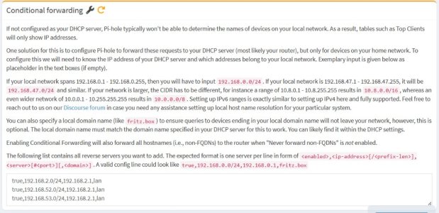

  • On the Pi-Hole DNS Settings page under Conditional forwarding follow the examples to input your router's main LAN and any Guest Network Pro profiles in the format the example indicates (ex: true,192.168.0.0/24,192.168.0.1,fritz.box). Make sure to apply any changes to the Pi-Hole settings.
