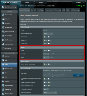

Hi Everyone,
I've purchased the RT-BE92U as a replacement for my ISP's horrible router and everything was working fine when I got it, but then when upgrade 3.0.0.6.102_38961 was released, the router automatically upgraded the Firmware and there was no more Internet connection on WAN (took a bit to figure out what happened).
Managed to downgrade the firmware to 3.0.0.6.102_37563 (as that's what the router was shipped with) and all started working again.
The main issue is: There is no more 802.1Q settings in the WAN -> Internet Connection settings page.
I was reading the release notes, but can't see anything mentioned regarding. Is this setting now hidden somewhere else or completely removed?
The 3.0.0.6.102_37563 is quite old at this stage, not sure if it's good to run the Router on this Firmware until EOL but could you suggest anything regarding please? WAN connection won't work without the 802.1Q settings (VLAN ID and 802.1P).
Thank you for your help!

3.0.0.6.102_37563 is before firmware 3.0.0.6.102_38961. 3.0.0.6.102_38961 recommends factory resetting after updating. Likely you'll need to update to the latest, then do a factory reset, and recheck if the menu shows up.
I have heard that with ASUSwrt 5.0 it was in fact moved to LAN IPTV as @degrub notes, but that is not the case with your prior firmware, which was also 5.0 as it is 3.0.0.6 .
I checked ASUSwrt 6.0, and it is back on the WAN page. Maybe ASUS regrets moving it and put it back....
