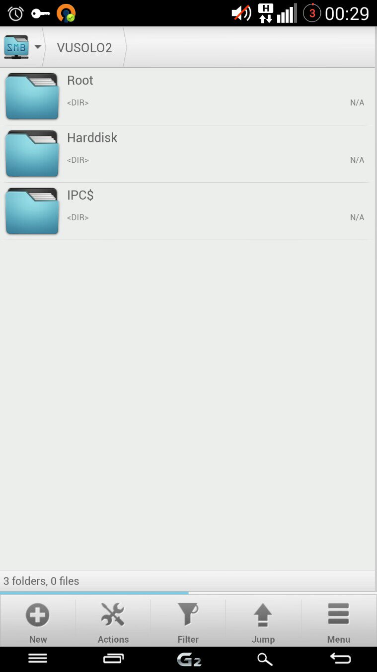

I'm using TUN, and can access my whole Lan from outside. I'm using the ip addresses, don't think I can use host names but I've actually never tried. So something must be wrong with your setup, works brilliant over here.

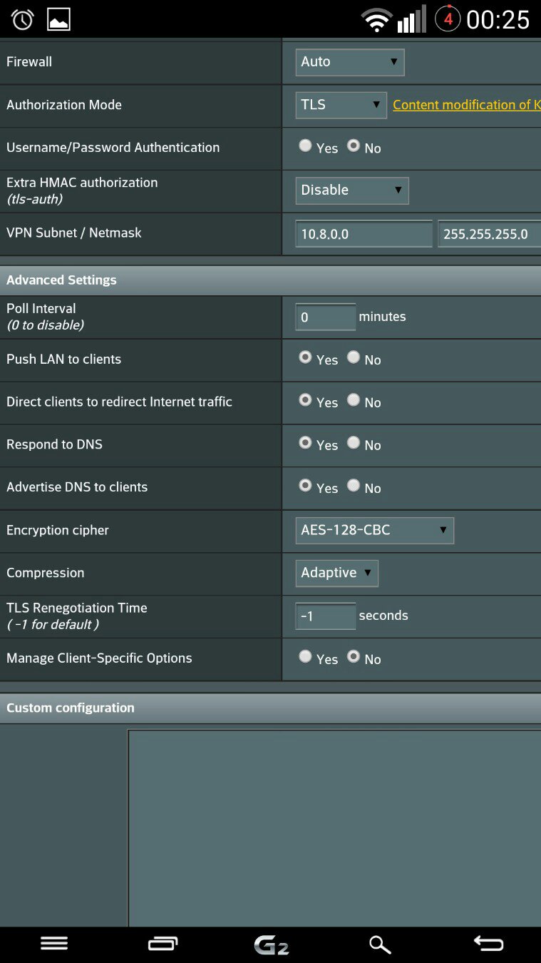

Could you kindly take a look at my setup in the 1st post above? That's all I have right now.
I thought it's because the VPN IP address given to the client device is set to a different subnet than what I have for my LAN, but I can't even change the VPN subnet. I get:
Conflict with router's DHCP IP pool xxx.xxx.xxx
I also have a different subnet (same as yours) and it works.

Here is my setup, using tun and tcp if that matters.

Yes, see screenshot above, connected to my set-top box samba share with solid Explorer, can connect to all my equipment, rpi, boxee, all routers, just everything. Like I was connected to my local Lan.
