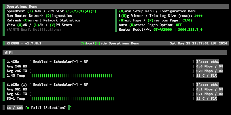

Hey @visortgw ... could you please send me a screenshot off your AXE16000 to make sure that the wifi page looks like it's populating OK? Wanted to make sure that the 2.4GHz, the 2 x 5GHz and the 6GHz visualizations come up right?

THANK YOU!!!
This is why this is so helpful when you don't have a device like this to test against... :) My OCD thanks you. You ROCK! :)
@visortgw ... if you see anything else out of alignment... the wifi page should really be the only one since the AXE16000 is so unique, but just let me know.
I just updated the script, so you can download/overwrite... and this wifi page should look aligned now. :)
@Viktor Jaep: I was wondering how much that would bother you (I noticed the same, but I didn't dare mention it)! 🤣
It bothers me more than you can imagine... alignment OCD is my downfall. ;)
