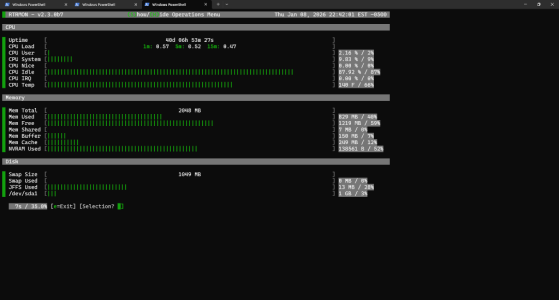

Wish I could say screen 7 works for me but, this is what I get on rt-be88u and xt-8.
RTRMON v2.3.0b7
That is exactly what I am seeing.
Hooray, I am not going bonkers... actually I am, but it's not due to RTRMON.
RTRMON v2.3.0b7
Ah. I found it. It was working when using the -monitor command, but not the -screen command. I found the culprit. Please download this same version, and try again. The command rtrmon -screen 7 -now should work now! :)
curl --retry 3 "https://raw.githubusercontent.com/ViktorJp/RTRMON/develop/rtrmon.sh" -o "/jffs/scripts/rtrmon.sh" && chmod 755 "/jffs/scripts/rtrmon.sh"
