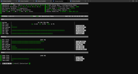

Is such a high memory usage expected? I have a RT-BE88U, running RTRMON V2.2.2. Only happens when RTRMON is running. Otherwise memory usage is around 700MB
Not sure why you are seeing high memory usage but, I also have a RT-BE88U on FW: 3006.102.5 an see no difference with the same RTRMON version running or not. I am seeing some differences in what the router reports in the GUI and what RTRMON reports.

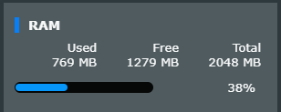

@scootertramp, really weird behavior on my router. This is what I see on the SSH session:
And this is what's in the GUI:

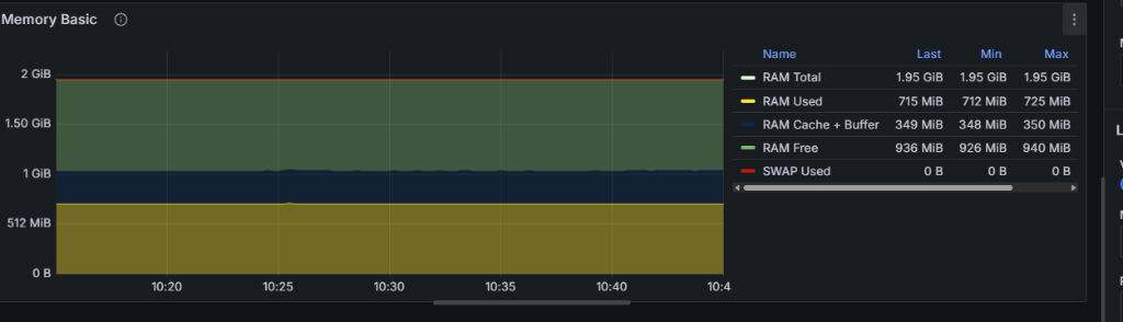

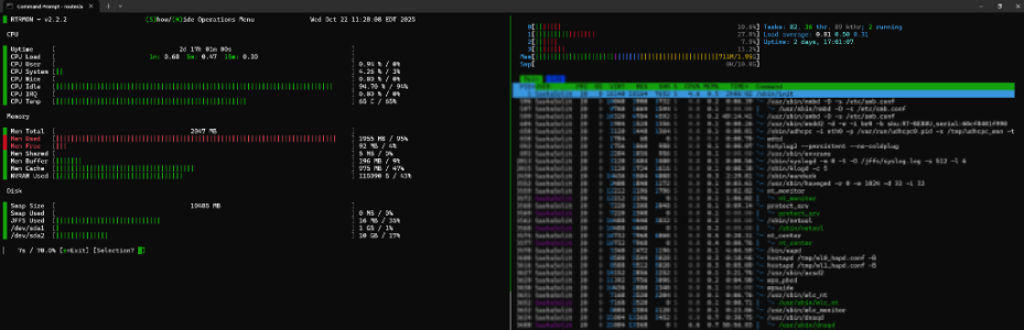

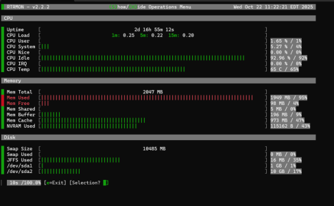

More data that makes it seem that RTRMON might be mis-reading memory usage.

Uninstall and reinstall seems to have solved this issue. Memory usage is being reported correctly. However, and this issue existed before the uninstall/reinstall, there are a few devices that are being shown to be on the Guest network, even though they are on the main AiMesh
I pull my stats directly from the top command. They match to a dime.
If I'm not mistaken, what you currently see in RTRMON is what you used to see in the GUI, until a change was made maybe about a year or so ago where Merlin was longer including the cache+buffer in the mem used number. When you subtract the cache (+ buffer) from the mem used, you see a figure closer to what you see in the GUI. There was some debate about this in the past. I've left my stats in place as-is.
Uninstalling RTRMON has about the same effect as deleting a 100K text file on your laptop and expecting results to change. It doesn't consume more than a MB or 2 of RAM when running. If you want to send a screenshot of what you're seeing with the Guest network/iMesh issue, I can definitely take a look at that. I personally don't use iMesh, so you'll have to bear with me trying to troubleshoot this, and may need to pull in some help from the @ExtremeFiretop BIG GUNS to see if he experiences that same issue.
@Viktor Jaep , did you see my other post above (#346) where I posted the memory usage from RTRMON and from `htop`? They differed significantly. The reinstall definitely did solve the memory issue, FWIW
