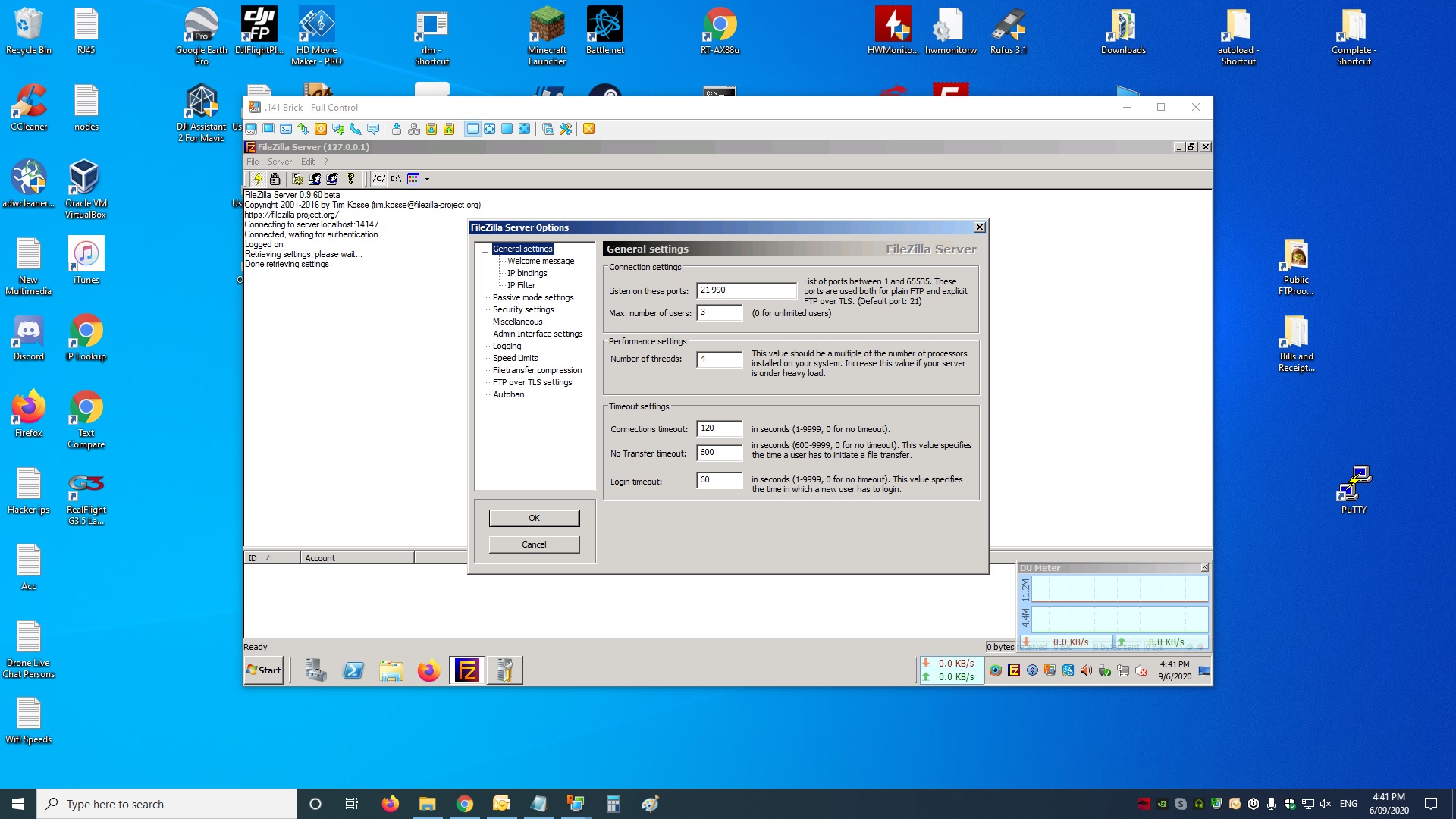

I'm currently using FileZilla Server to run the FTP.

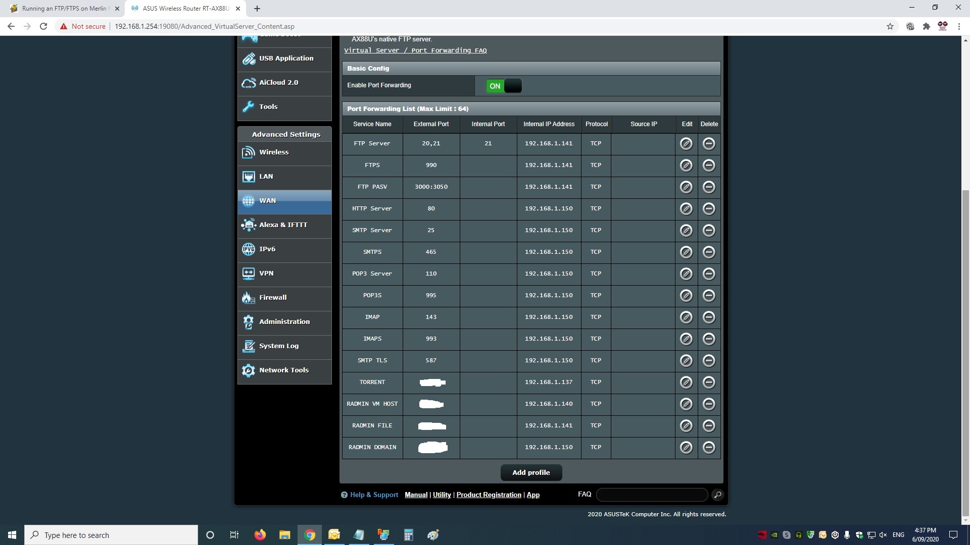

My setup in the firmware is this.
So first question is Port Forwarding the a choice then Port Trigger?

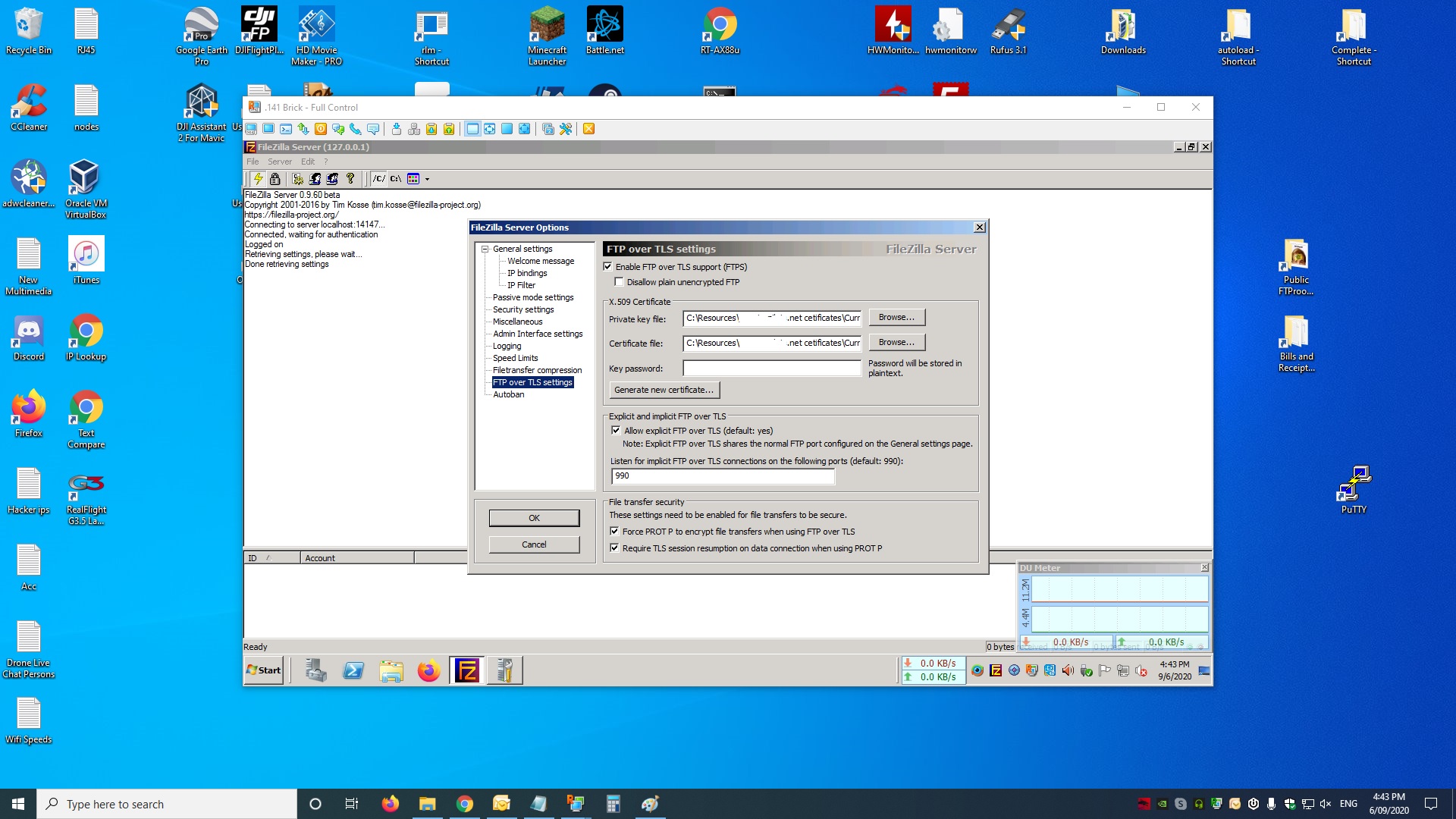

Now onto FTPS
If I enable it are the x.590 certificate a requirement?
Also based on the 990 default port does that require another port forward?
I can't think why anyone would use Port Trigger for this, but I suppose it depends on your use case.
The reason I asked is because Asus example for a setup is using an FTP but it maybe specific to the use case as you say.
I was able to switch the server to FTP over TLS and everything is working after some troubleshooting.
Once I changed the client software to passive!

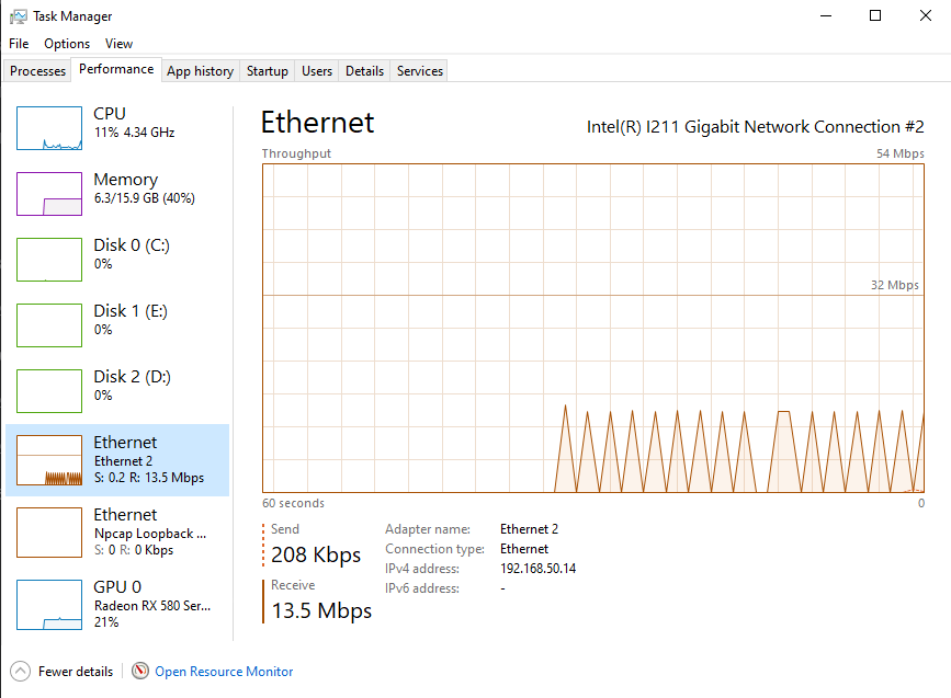

These days I just use the task manager since it doesn't require me to install anything.
I use DUMeter mostly for the network traffic totals and review data in bound and out bound to get an idea of anything odd that might be going on.

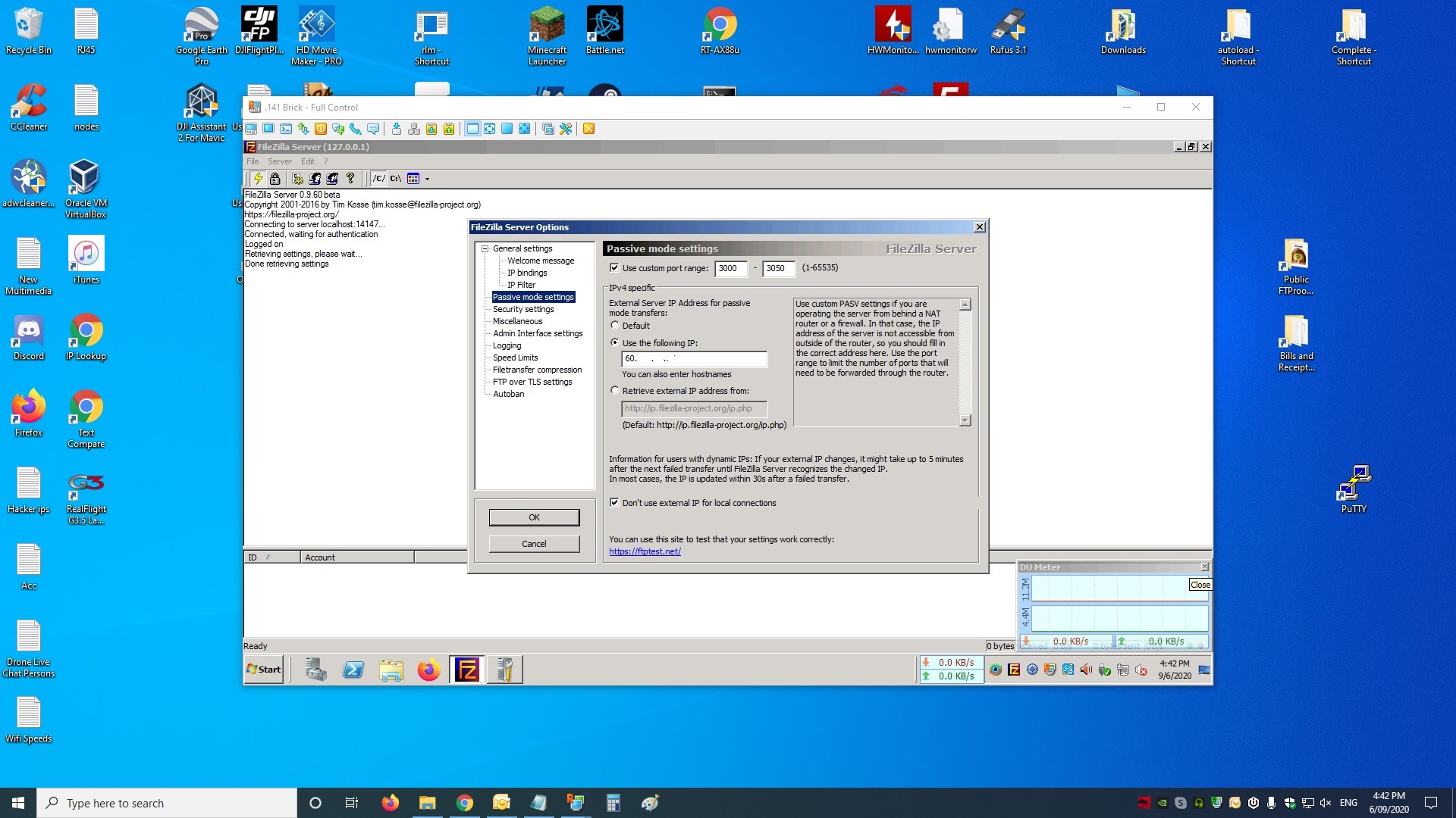

I use filezilla behind a router too, but I don't have a fixed IP and I need to use a DDNS.
I have a problem with passive FTP. The server needs to know my WAN IP for the PASV reply. There are two options in filezilla:
- Ask the DNS (router) for the IP of DDNS name. This doesn't work because the router replies with local address of the server.
- Ask a remote web server that sends back the IP address of the incomming connection.

I was just checking this and I am able to recreate your issue.
The server has been configured to use the DDNS instead of IP.
If I go to https://ftptest.net and test it.
The main problem the OP was having was that the router's DNS server was returning the router's internal IP address instead of the external IP address when querying his DDNS name. That doesn't appear to be a problem for you because I'm assuming that's why you blanked out the IP address in the second line of your test log image.
I don't find this (PASV returning a private address) to be a problem because all the clients I use are aware of the problems with NAT and work around it. Filezilla client for example:
Command:    PASV
Response:   227 Entering Passive Mode (192,168,1,10,215,35).
Status:     Server sent passive reply with unroutable address. Using server address instead.
Trace:       Reply: 192.168.1.10, peer: 80.xx.yy.zz
Command:    PASV
Is there any method to get the WAN IP from Merlin fw as the sole content of a web page?
You are correct I see my mistake.
And yes after testing in the filezilla client I get in without the error from the test site.
