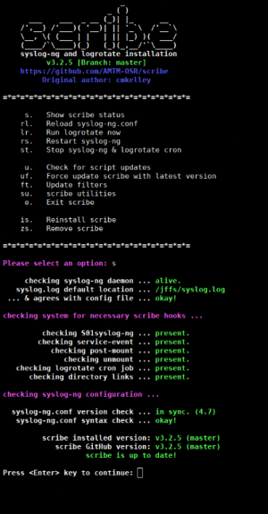

What does the Show scribe status command (i.e., s.) within scribe show for syslog.log default location?
 Please select an option: s
      checking syslog-ng daemon ... alive.
    syslog.log default location ... /jffs/syslog.log
  ... & agrees with config file ... okay!
 checking system for necessary scribe hooks ...
          checking S01syslog-ng ... present.
         checking service-event ... present.
            checking post-mount ... present.
               checking unmount ... present.
    checking logrotate cron job ... present.
       checking directory links ... present.
 checking syslog-ng configuration ...
   syslog-ng.conf version check ... in sync. (4.7)
    syslog-ng.conf syntax check ... okay!
          scribe installed version: v3.2.5 (master)
             scribe GitHub version: v3.2.5 (master)
                    scribe is up to date!
 Press <Enter> key to continue:

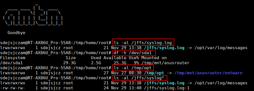

Does ls -al /jffs/syslog.log show the symbolic link?
# ls -al /jffs/syslog.log
lrwxrwxrwx    1 TheS1R   root            21 Nov 29 09:32 /jffs/syslog.log -> /opt/var/log/messages

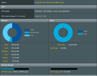

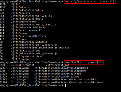

I ran some commands you asked for:
Screenshot from 2025-11-29 13-41-55.pngScreenshot from 2025-11-29 13-46-47.pngScreenshot from 2025-11-29 13-59-31.pngScreenshot from 2025-11-29 14-02-25.pngScreenshot from 2025-11-29 14-08-58.png
The screenshots and output shown in your latest post look correct, and they indicate that your Scribe setup is currently configured as expected. If your JFFS partition continues to get filled up again, I suspect it might be caused by something else, but perhaps it leads to a corruption in the Scribe functionality.
I have a custom shell script that I've used before as a diagnostic tool to monitor cases when either the TMPFS or the JFFS file system was being filled up slowly with large files over a period of a few weeks. IIRC, the last time was about 2 years ago, where the Traffic Monitor (or Traffic Analyzer??) was generating a very large database file (a little over 40MB). The log file generated by the diagnostic script and stored in the USB-attached drive showed the database file slowly increasing and filling the JFFS partition during the previous 3 weeks.
In your particular case, I don't really know what's causing the problem, but you could set up the diagnostic script to run as a cron job at a fixed interval (e.g. every 20 mins or every 4 hours), depending on how fast the JFFS is getting filled up and, hopefully, the log file will capture some rogue file(s) getting larger over time.
