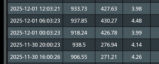

There's something odd happening with my spdmerlin, and I can't figure out what 😅
Whenever I run a manual Speedtest (auto server), it uses correctly my upload speed (around 400mbps).
Whenever it runs unattended via Cronjob, it's capped around 150mbps. Every single time . Auto server also.
However, if I run /jffs/scripts/spdmerlin generate in terminal (the Cron command), the upload goes up to those 400mbps.
Download speed is correctly tested in both scenarios (around 1gbps)
Any ideas why?

Thank you for your prompt help!
1 - no. Exactly the same. (I did notice however that controld binary is always using 55% of RAM 😯)
2 - Even with an even lower priority, manually triggering it (both via generate or interactive menus), the results are the same, with 400mbps upload. I'll wait for next real Cron to check.
3 - No. This is the only one each 6h (00h, 06h, 12h, 18h)
4 - No QoS activated. Also, the option to exclude from QoS is activated, just to be sure.
5 - Almost same results, negligible difference. I, however, use the external binary (I think is newer than built in?)

I just set the Cron to run every 5 minutes (for the sake of debugging), and you know what? Correctly getting my upload speed. 🫣
Maybe the cron job I set to run every 6 hours just happens to coincide with peak usage times on the ISP’s side? Hard to tell… either way, thanks again for the help. I’ll keep monitoring it.

Thank you for your alert, and no, I haven't got the reason behind that...
I checked and whenever a cron runs different from minute 00, upload is OK. Whenever it runs at minute 00 it caps the upload speed.
There are many crons running at 00 minute, of course.
So maybe the suggestion I have is an option to choose to run this cron X minutes after hour.
Use Custom option when setting automatic speed tests to choose minutes after hour.
There you go, reason found! Best solution provided by visortgw.
