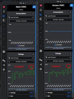

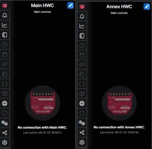

I have 2 Shelly 1PM Gen3's switching on and off Hot Water in the Main and Annex HW Cupboards.
They are on the 2.4GHz Wifi. None of my other 20-odd Shelly's have this issue.

They keep dropping off the Wifi at (every time) almost the exact same time.
They mostly come back up after 12-15 hours or so, not always after a Router reboot either.

I am leaning towards me needing RC Snubbers wired to each HWC Switch device (see Voltage Spikes, not sure if that is an issue or not), but if it's a Router Issue that is easier to fix (remotely).
