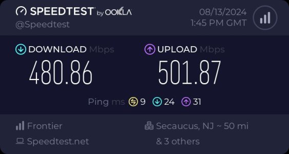

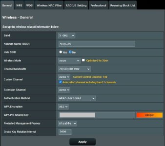

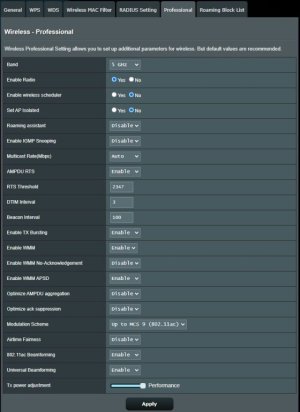

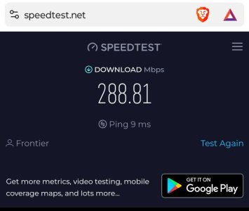

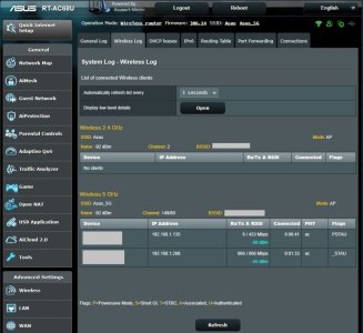

Used a RT-AC68U on a 500/500 MB fiber line for a short period of time and it worked fine. Got acceptable speeds for my use case. Due to updating to a newer WiFi 6 capable laptop, decided to update to a RT-AX86U Pro. Doing a quick and dirty test with that old RT-AC68U with a generic cellphone (WiFi 802.11 a/b/g/n/ac) and with a WiFi 6E capable laptop on that 500 fiber line yields the attached results. Also included are the WiFi Log, and WiFi settings on that RT-AC68U. It shows that it is possible (at least with a speed test performed from the WiFi 6E capable laptop) to achieve close to 500 Mbps broadband speed on WiFi. The Wifi Log indicates 866 RX/TX rates for that laptop. (PS: I don't use AiProtection. Router at generally default settings, do run YazFi on that RT-AC68U router.)

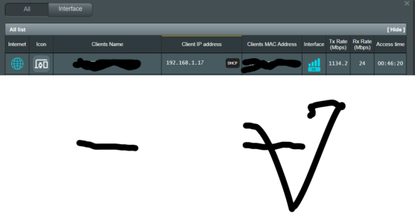

I have Comcast which is rated 500/20, although should test to 600/24. On my Pixel 8, I can get into the mid-upper 400's. (and nearly the full 600/24 on a wired computer.) I do have AiProtection and many other stuff turned off, so the router is running about as basic as possible.
