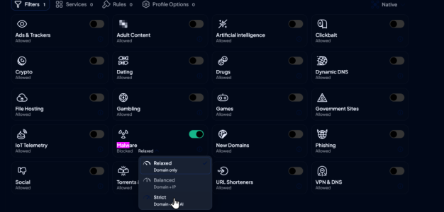

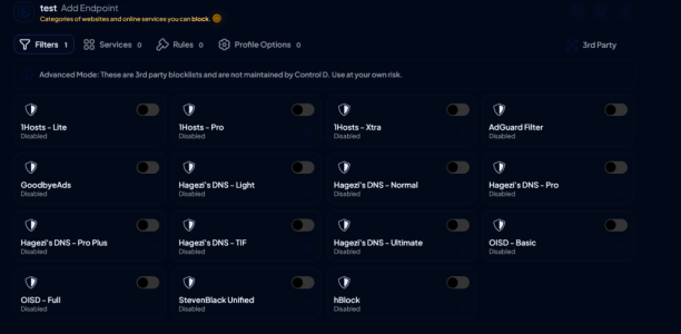

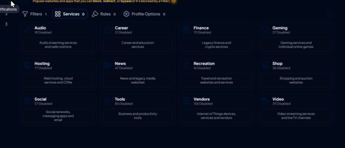

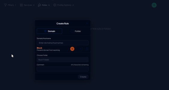

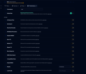

They are not bad I guess...I attached a few screenshots of a profile I made, and you can see native and 3rd party filters... you can also block or redirect popular services to other countries depending on your plan with them..the block works on regular paid plan and redirect i think u need the next plan. But I think the main complaint about them I've seen is speeds if you don't live close to ctrld dns servers....but I don't know maybe they've improved on that or maybe that's not much of an issue anymore, really have no idea. I don't mean to be advertising for them at all, just thought I paste these since you weren't aware of them. For me I mainly just use them for the filters as i guess many others do, the second screenshot (3rd party filters) and last screenshot, native filters
