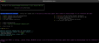

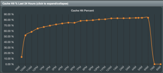

Hi, all.
RT-AX86U 386.3_2
I setup unbound, yesterday, using unbound_manager 3.22. Everything went fine. This morning when I woke up, it wasn't running.
Found this is syslog:
Oct  9 06:58:49 kernel: EXT4-fs error (device sda1): ext4_find_entry:1461: inode #3934185: comm unbound: reading directory lblock 0
Oct  9 07:00:00 (unbound_rpz.sh): 9620 Attempting to Download 1 of 1 from https://urlhaus.abuse.ch/downloads/rpz/.
Oct  9 07:00:00 (gen_ytadblock.sh): 9619 Warning unbound NOT running!
Does this look like a failing flash drive, or something else?
