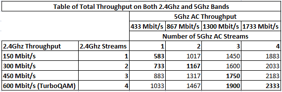

You can expect more performance from a 4x4, 3×3, over a 2×2, 1x1 for several reasons.
802.11ac, 5GHz:
4x4 provides a maximum throughput is 1.7 Gbps (4 x 433 Mbps)
3x3 provides a maximum throughput is 1.3 Gbps (3 x 433 Mbps)
2x2 provides a maximum throughput is 866 Mbps (2 x 433 Mbps)
Note that the maximum speeds are used for reference purposes.
Yes R7000 is a 3x3 AC Router, 600 Mbps on the 2.4GHz band and 1300 Gbps on the 5GHz band, its a AC1900 Router (600+1300).

Then 4x4 = 1733 mbit (R7800)
I follow the analogy but what are AC3100 routers?
5x5 doesn't exist?
Like the TP-LINK C3150 and ASUS AC3100 (AC88U) are 2167 mbit. How can they be 4x4 and 2167 mbit :)
AC3100 ultimate AC performance : 1000+2167 Mbps

The R7800 supports 256 QAM, AC2600 Mbps (800+1733)
4x4 11ac-80 MHz + 2x2-160/80+80 MHz
In order to benefit from QAM technology, the client who connects must also have QAM support.
And to benefit from 160MHz and MU-MIMO features, WiFi clients needs to support and be 160MHz and MU-MIMO capable.
Devices that don't support 1024-QAM, maximum link rates work out to 600 Mbps in 2.4 GHz and 1300 Mbps in 5GHz, thats goes for all this Routers.
