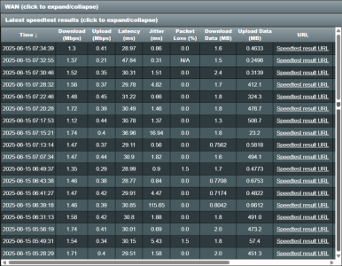

Hello again,
I'm reporting again regarding the numeric values bug I reported a few days ago. Today, while I was having my usual look at the latest automatic Speedtest results it came to my attention that numbers are showing consistently incorrect again!
So, I immediately made a few manual speed tests, but processing the numerics showed random results (alternating between new and old display) with no specific pattern that I could recognize for troubleshooting.
Moreover, for more troubleshooting, I tried switching between built-in and external Speedtest binaries (spdMerlin v4.4.10) to no avail, so I went with a first impression that it's caused by having multiple code paths for processing numeric values and the bug fix isn't applied to all code paths, or it could be some bug with processing Speedtest result's text itself. And I was about to report this first conclusion.
Anyway, I had an idea to try and check if there's any new code in the develop branch, and to my expectation, there was (v4.4.11)! I made more speed tests and the bug vanished completely with both Speedtest binaries (since there's a new external binary with the new version in development).
However, I thought it could be helpful to drop this information here for you guys, @Martinski, @ExtremeFiretop. It might be a bug you're already working on and/or already fixed.
Attached is a screenshot from my Last X Results table, showing automatic test results at the very bottom, then some test results with v4.4.10, then at the very top some test results with v4.4.11.
EDIT #1 : Re-wrote some points for clearance. Added more details.
EDIT #2 : Mentioned members.

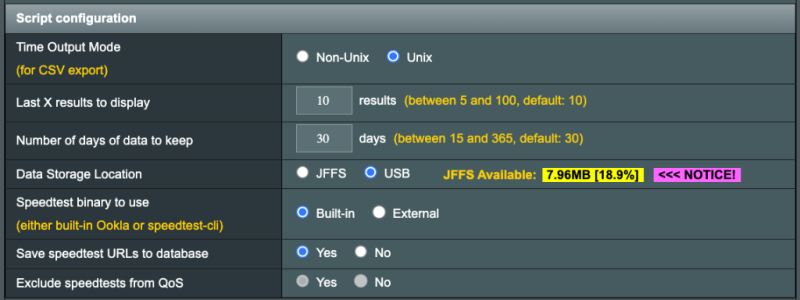

It seems like it thinks I'm still using JFFS, and triggers a false warning. My real JFFS is 13.54 / 44.46 MB according to ScMerlin, so it must count what I have used on USB (SSD).
Also, last row. Is that supposed to be grayed out? Don't think it used to be that.
Update: spdMerlin show correct JFFS in CLI. So just GUI is affected.
Currently, the "Exclude speedtests from QoS" radio buttons are grayed out if you have enabled (i.e. set to "Yes") the AutoBW configuration. Double-check your settings to be sure.
The "JFFS Available" message is displayed whether your "Data Storage Location" is set to JFFS or not. The intention is to let users be aware of the free available space in case they try to switch from USB.
The "NOTICE" tag (not a Warning) is displayed whenever the available JFFS space goes below 20% of total space or 10MB (whichever is lower) after a database operation was performed. This is intended to be a heads-up message to let users know the JFFS free space may be getting "dangerously" low at some point.
If the numbers do not match, you will need to refresh the WebUI page to get the latest report from the CLI menu.
A refresh does not help. Also cleared all browser data and checked with several browsers. I have used USB since the setup of spdMerlin. The WebUI does not seem to know that USB is used.
All scripts that can use USB for data has that option enabled. Nothing else but spdMerlin shows incorrect JFFS.
Not a major issue, but still an interesting glitch.
Update: away from home and used Chrome via VPN on the phone. Suddenly OK. Will check when home again.
Update 2: Something made it work even on the Mac browser when I remotely controlled it. I see it as solved, whatever that solved it.
