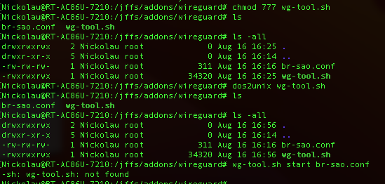

As I said, @Jeffrey Young, trying to run your tool and got stuck. Newbie here! I will try to explain my steps from where I was:
  1. ssh to the router
  2. uninstalled Wg manager (remove interfaces and got it uninstalled)
  3. Created /jffs/addon/wireguard folder
  4. ran the installation code "curl --retry 3 https://raw.githubusercontent.com/Bandsaw12/Asus-Merlin-Wireguard/mai
    n/wg-tool.sh" but nothing happened.
  5. created a wg-tool.sh file and copied your scritpt to it.
  6. created an interface.conf file with my data into it.
What else should I do to make it work?
Did you set execute permission on the tool? Also since you did a copy paste, run a dos2unix command on the tool as well
Did I do it right?

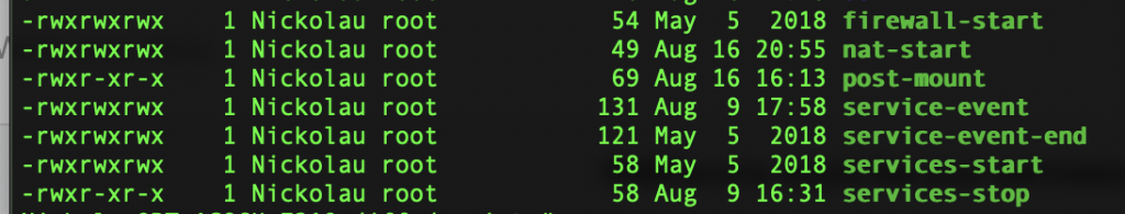

So what I have done:
  1. cd /jffs/scripts/
  2. Edited the firewall-start and added
    #!/bin/sh
    /jffs/addon/wireguard/wg-tool.sh firewall show
  3. added with 'nano' the file nat-start with
    #!/bin/sh
    /jffs.../wg-tool.sh nat show
  4. added with 'nano' the file services-start with
    #!/bin/sh
    /jffs/.../wg-tool.sh start br-sao show
  5. Executed the "chmod a+rx /jffs/scripts/*" to change permissions
  6. rebooted.
Not working. No access to internet. I have this error:

Take the word "show" out of the firewall and nat scripts and reboot.
Did it, still the same.
And also ran some tests. I commented each file and rebooted. No luck.
#!/bin/sh
/jffs/addons/wireguard/wg-tool.sh firewall
  GNU nano 5.7                                                 nat-start
#!/bin/sh
/jffs/addons/wireguard/wg-tool.sh nat
Did you apply execute permission to each of the scripts?
