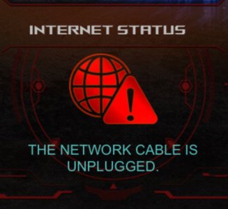

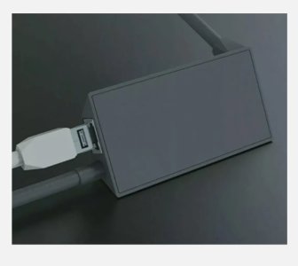

I’m trying to connect Starlink with Asus Router but couldn’t get it to work together.
Had my rj45 cable plugged from the Ethernet Starlink adapter (image attached), but my asus kept not working. All entrances tried just in case and different cable. Wondering what’s wrong!

You have to put the Starlink box into “bypass“ mode; until you do that the Ethernet adapter is useless. This requires the Starlink app on a phone, logged into the Starlink wifi, and it disables the Starlink wifi. If the Starlink gets a factory reset you’ll have to do it again, and power failures can generate a factory reset. It’s not a great setup. Though when it’s working it works well.
