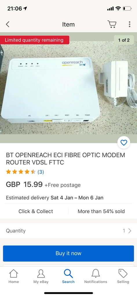

If you don’t care about using the Sky app on your phone you could wire the Sky boxes directly to the Sky router rather than the Asus so they are not double NAT’d, but really it comes down to needing a proper modem again for a clean solution.

Not talking big money!
That is cheap, I will let him know.
