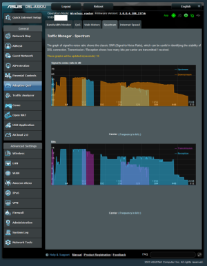

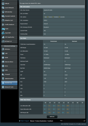

I have an Asus DSL-AX82U (standard firmware). The device is connected to my VDSL line with 250/50 (Deutsche Telekom).I have the problem that after about 4 days (mostly after 3) I have significant problems with online games (shooters). My shots no longer register, etc. I was able to solve the problem by rebooting the router.I reported a problem (Deutsche Telekom) and now I have the problem after just 1 day. My provider can't find anything wrong. They say everything is fine. A tool called "ASSIA" is currently running on my line because I restarted the router too often. I would have triggered it.
My bandwidth is currently throttled to 225/37, but that's not my problem.

I do not want to hijack your topic but I have the same router with the same connection in Germany (Telekom MagentaZuhause XL) and if you do not mind, I would like to ask some questions from you. The connection at my location is limited to 175/40 which I am fine with, but I have never seen sync rates like you show on your picture with my device (the best the router achieved was around <140000 Kbps). I reported this issue to Deutsche Telekom and had a technician visiting me the other day who told me that the TAE-F to RJ11 cable that I have chosen is not the best and since the connection in the wall looks OK, this could be the root cause of my low rates. Do you mind telling me which cable are you using for the DSL-AX82U for your VDSL connection? Also, if you could send a screenshot of your Administration -> DSL Settings page that would be awesome. Danke im Voraus! :)
