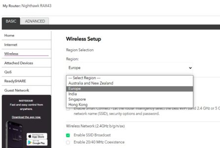

Noted, thanks. But I'm sure I don't have a US model even though the model number has 100EUS appended to the name. I know it was supplied by a UK retailer and the power supply is 220V and not 120V.
Also, the wireless Region Selections are Europe, Australia & New Zealand, India, Singapore, Hong Kong.
No mention of USA!
Set the router to your region. If your region is not available in settings - your router is incorrect model for the region.
This is all I can suggest with the extremely limited information you provide missing even the basics - your country/region.
I'm in South Africa. I presume the region is Africa. Even my previous router the R7000 worked seamlessly having region set as Europe
