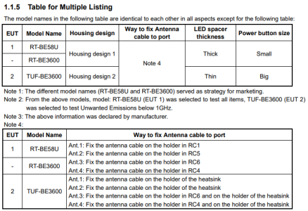

V1 was using Broadcom BCM6764LKFEBG for RT-BE58U, RT-BE3600, and TUF-BE3600 according to internal photos from FCC MSQ-RTBE7900.

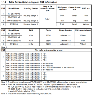

For V2, I'm guessing they swapped the Broadcom chipset to BCM6764KFEBG. This seems to be true for other manufacturers (TP-Link, Netgear and etc). Anyways, we'll know soon enough once FCC release the V2 internal photos on 12/21/2025 FCCID MSQ-RTBE8Y00.

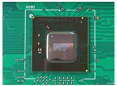

Now that FCC have uploaded the V2 internal photos, RT-BE58U V2 / RT-BE3600 V2, TUF-BE3600 V2, and RT-BE55 is confirmed to be using BCM6764KFEBG.
