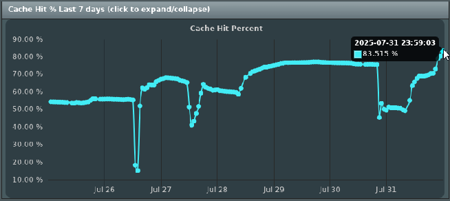

Hello does anyone know why my unbound would be close to 40 cache misses I had a previous setup on my old router and I was close 90%+ hit rate. Could there be something wrong with my settings?

Unbound made changes to the way serve-expired is now handled.
By default, the serve-expired-ttl is now 86400 seconds (rather than 0 - ie infinite), and serve-expired-client-timeout is now 1800ms (Time in milliseconds before replying to the client with expired data. This essentially enables the serve-stale behavior as specified in RFC 8767 that first tries to resolve before immediately responding with expired data. Setting this to 0 will disable this behavior and instead serve the expired record immediately from the cache before attempting to refresh it via resolution.)
This means if DNS can’t resolve with a “clean” reply within 1800ms it will then (and only then) serve the expired/cached reply.

You need to override this one and set to 0 in your config, otherwise it will default to 1800ms:
serve-expired-client-timeout: 0

I can report after 1 hour with this change the cache hit % doubled to 50% and climbing. Surfing is back to what it used to be where it was zippy and there wasn't that pause with every click.
