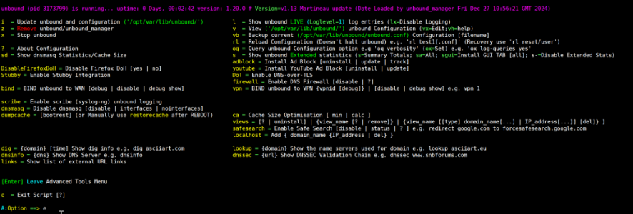

By default unbound_manager starts in basic mode
and option 1 is to be used to reinstall/reset the current installation i.e. rather than tediously uninstall then reinstall any new installation modules etc. are retrieved from Entware.
If you start unbound_manager in 'advanced' mode, you will be able to access a comprehensive tools menu using option 3
unbound_manager    advanced
You can then edit the config file by simply using command vx which invokes nano to perform the edit.
EDIT: I get it. It reads config file only once - on startup, there is no option to make it reload config from changed file in any other way.
You can load ANY config file inflight without needing to stop unbound by using the advanced menu command rl command.
You can use the vb command to backup the config file so you can test individual directives and save different versions of the config to easily restore using the rl command.
