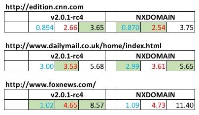

Thanks for the info, so if I decide to use unbound nxdomain, is the recommended way to go is to turn off diversion and pixelserv tls correct?
As mentioned the difference is that diversion with pixelserv-tls responds with “yes that domain exists and here is the IP you want” while pointing to pixelserv. Then the client opens a connection and get a single pixel.
In unbound the clients gets “sorry, that domain doesn’t exist”. And the client never tries to open a connection.
It really depends on the client which is better. But adblock detection nowadays can detect both as they typically download JS and set a variable or something like that and both will not do that.
You can see what type of requests are being made from your clients at:
http://[pixelserv ip]/servstats
And look for the different types listed
nfe	137	# of GET requests for server-side scripting
gif	3	# of GET requests for GIF
ico	0	# of GET requests for ICO
txt	23	# of GET requests for Javascripts
jpg	0	# of GET requests for JPG
png	0	# of GET requests for PNG
swf	0	# of GET requests for SWF
ufe	149	# of GET requests /w unknown file extension
Kvic did some testing a while back now (2017) and at the time the results for performance between using pixelserv and NXDOMAIN was close.
https://kazoo.ga/pixelserv-tls-v2-benchmark/

Precisely which 'stats' metrics are you referring to?
I suggest you spend some time studying my metrics I posted here.
In summary, the left-most column will always be reset to zero, whereas the right-most column should remain quite close to the pre-restart values (although it appears some internal housekeeping occurs, to presumably flush stale cache entries).
