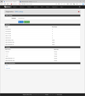

I ran DNS lookup. Did you notice 127.0.0.1 shows in diagnostic as 180 msec whereas QUAD9 is 18 msec. Why so long on the loopback IP.
180ms is due to dns encryption, but it is not that big to cause problems.
Also, since you use 9.9.9.9 as dns on laptop and still have the problem, it is not pfsense related.

Here's mine pretty much at 0ms.. Yeah 180sec was a lot..
