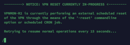

I didn't do a manual reset, the script itself does this and shows the following message
So to be clear... the script isn't functioning for you at all? You are just seeing this "retrying" screen right now?
The only way you would see this screen is if a $LOCKFILE (="/jffs/scripts/VPNMON-R2-Lock.txt") is present on your system in this location. It works fine on my end, but perhaps it doesn't like the long filename thing on your end? I guess I can shorten it to 8chars on the next go-around to see if that makes a difference?

    echo -e "${CGreen} Retrying to resume normal operations every $SPIN seconds...${CClear}\n"
Screenshot of my console when using a commandline -reset, the lockfile is written, and flips over to the same screen you're seeing.

In this particular scenario, it detects that the wan connection is down, but the link is up. It will attempt repeated VPN resets (a lockfile is created), and testing your WAN for connectivity. If there's no connectivity, it will delete the lockfile, and fall back to this screen your seeing, and wait 60 seconds before trying again.
Yes, even VPN's are disconnected, as the Kill function has already been executed.

its stuck here
