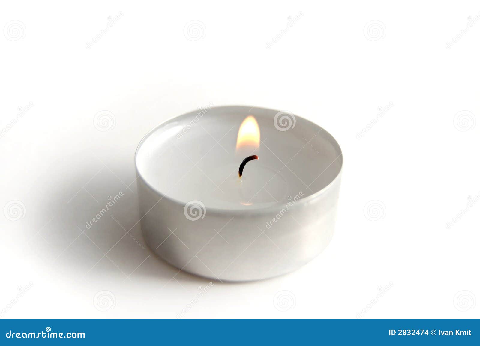

I attached my router to the wall using two long nails and the metal cup of those small candles as spacer to keep good air flow
1) Buy two (or more) of these candles
2) Use them till there is no wax or remove it manually
3) Open a hole in the middle of the cup where the nail will pass through. Be gentle as if you use too much force the cup will be crushed.
4) Put a cup on the wall and a nail to attach it firmly. Don't push the nail all the way in but leave some space so that you can hang router. Again be gentle as you don't want to crush the cup
I have kept my router attached to the wall for long time and never had problems
