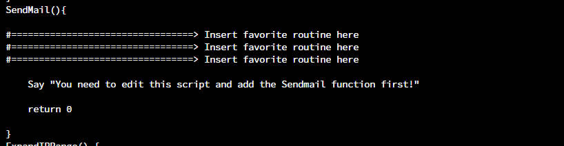

Thanks for that! I am curious how the email function works? Looking at the script, the sendEmail function does not have any code in it. I would like to send it to my email everyday by running a Cron job.
I just used nofilter and returned the correct amount of data usage. Now, I want to send this to my email, So I will add a CRON Job to the script. How do I add the sendEmail function?
Originally I hard-coded the in-line SendMail() function for a Gmail account and at the time was criticised for not supporting other providers.
Things have moved on in the four and a half years since I wrote the script, and external support for other email accounts is now available via the em feature of amtm.
So if you setup your personal email credentials in amtm you can simply copy'n'paste the following code, either as a stand-alone script for use by cron or edit TrafficAnalyzer.sh either to call the stand-alone script
i.e. change line
    Say "You need to edit this script and add the Sendmail function first!"
to
[ -f /jffs/scripts/AMTM_Gmail.sh ] && sh /jffs/scripts/AMTM_Gmail.sh "/tmp/TrafficAnalyzer.txt" ||  Say "You need to edit this script and add the Sendmail function first!"
or include the code in-line as the 'missing' SendMail() function

Awesome!!
Just pasted this in the script then it worked out instantly. I will set it at a cron job which sends me the stats every 12 hours! thanks again!
