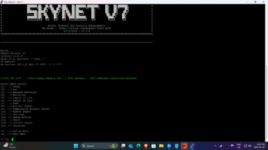

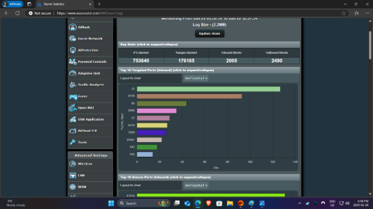

Everything is showing up on my end and I tested all blocklists. Might need a better router to use this list. It also might be the storage device you are using. Sometimes they need to be replaced. Mine shows 700000 blocks and close to 200000 ranges blocked
