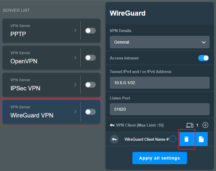

In the Wireguard Server setting on the router, did you enable Access Intranet?
[Wireless Router] How to set up WireGuard® VPN server?
No problem using stock WireGuard settings on Asus-Merlin firmware to access local network clients from an Android phone with the Access Intranet option enabled and the Wireguard IP's set to 10.6.0.1/32. One may have to configure local network device firewalls to allow access from the 10.6.0.x range used by the WireGuard tunnel if those devices block access from ranges other than local LAN default.
From the Asus link, an example of the WireGuard Server settings showing the Access Intranet option.
