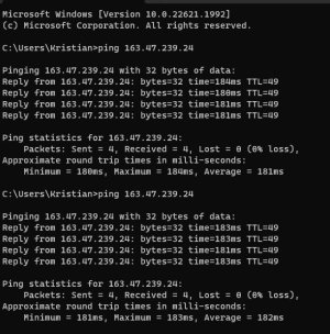

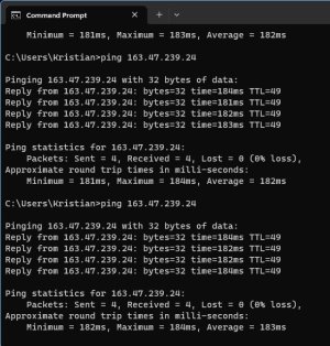

What do you get if you ping wan to wan without wireguard? If its still high, it may be what it is, not much to do.
Some protocols works better with high latency then others. Ftp is rather good for file transfer atleast better then smb. Would guess http would be better then https but dont have anything to back that up.

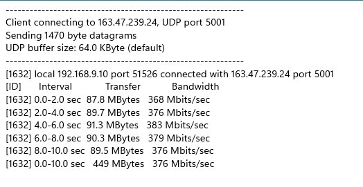

Did you try iperf with "-P 10" option?
Very similar results.
Yup, as attached. Looks like around 10 per stream going down, ~100 total; and average about 5 up, ~50 total.
An average of 94Mbit/s is not bad, it would be what I would expect from 100Mbit connection.
The reverse test seems more flaky with more varying speeds across the streams. Still around 50Mbit/s... not sure if your link is to blame or processing power used to generate the streams. You could try to use some rpi to run iperf on instead of the router. Or accept that speed is probably not your issue.
