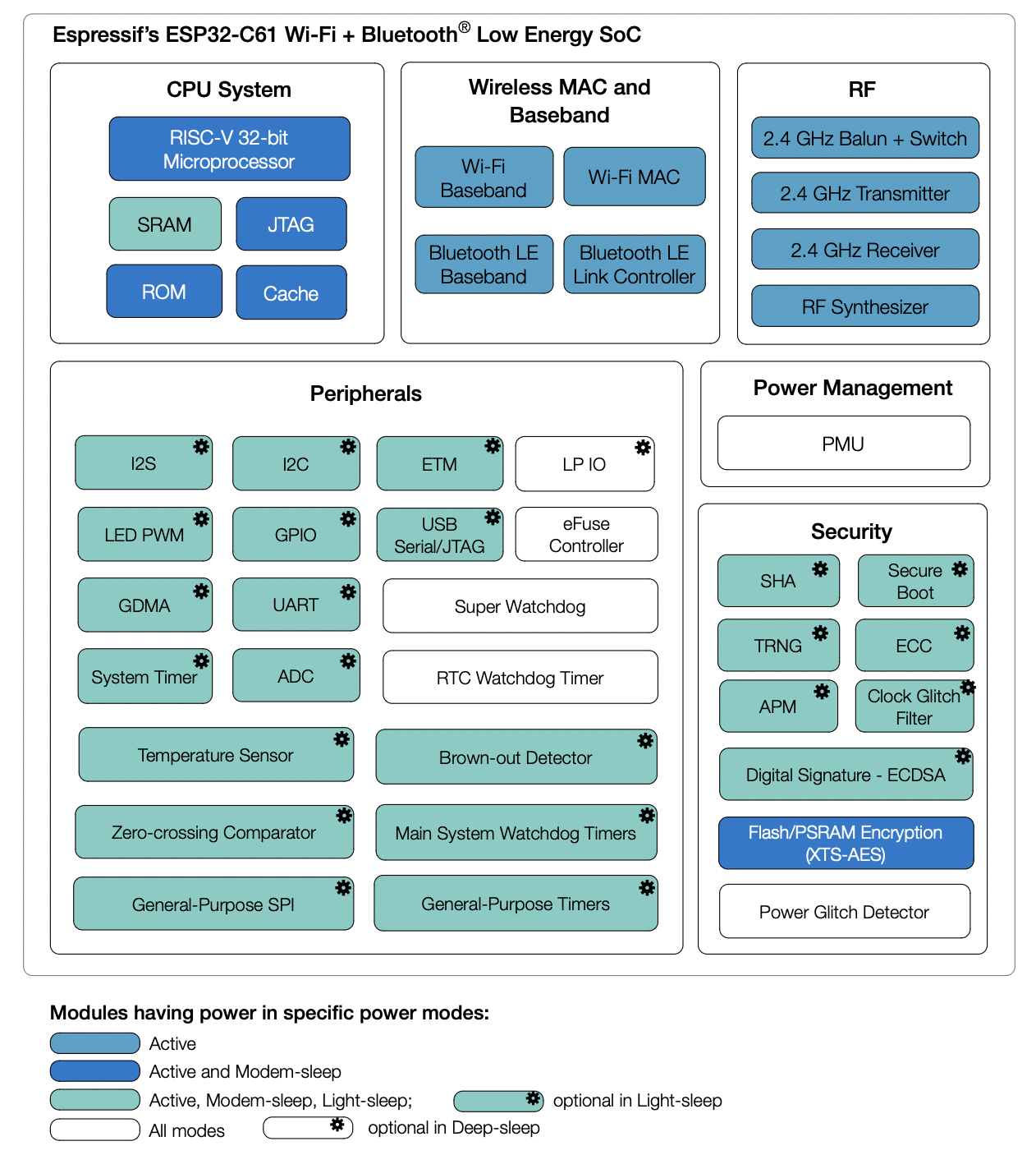

Are there any new IoT devices with 802.11ax/WPA3 on 2.4GHz support?
The chipsets are out there... here's a few that are focused on IoT
Just tested this. I have just one device that will connect quite freely to an ax/WPA3 network - my washing machine. Other than that all my IoT devices trip up on wpa3, though they all connect just fine to a combined wpa2/wpa3 network.
