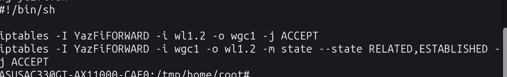

I did add one more rule for my other guest to work with wireguard:

Yes, that is from the YazFi client. The router can do it no problem.
