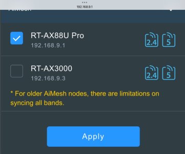

I have one guest network set up with 2.4, 5, AND 6 GHz. I cannot push that guest network to node(s) that are 2.4 and 5 GHz only. Is that clearer?
Right, got it now. Wow that’s interesting, sort of limits you to buying nodes that have 6GHz… but it makes sense. Just to confirm, if you configure that network for 2.4 and 5 only (delete the 6Ghz band), then it works (get pushed to) the nodes?
Yes, you can opt to push it to the nodes with 6 GHz disabled for that particular guest network.
