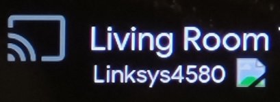

I have the 4G AC53U router and I'm trying to get the Google Chromecast to work together with it. Until recently I could use the 1.Gen CC together with the router, but it stopped working. So I tried to reset the CC, the setup went fine but I can't connect from the Google Home app, it just says "Connection ended" right after I try to connect. And the CC is not visible for other apps, like youtube, netflix etc.
So I bought the 3.Gen CC, and I have the same issue there, but there I also get an error icon on my TV screen. I'm reposting the icon from Google Support Forums.
