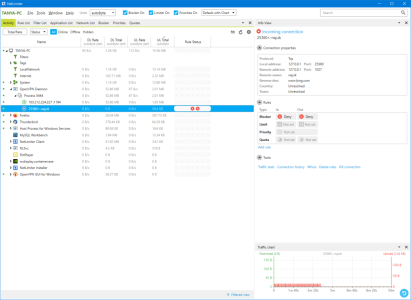

netstat -ab
C:\Users\Tanya>netstat -ab

Netlimiter.
There is nothing suspicious in your output.
openvpn-gui.exe is connecting to the openvpn.exe management port (127.0.0.1:1027>127.0.0.1:25360).
The only thing that's confusing is your PC's name resolution is returning nonsense. It's saying that IP address 127.0.0.1 is naj.sk, www.bing.com and www. That looks like you're using an ad-blocker that returns 127.0.0.1 for blocked domains.
Ok, so the constant 6bps incoming data is not an issue.
