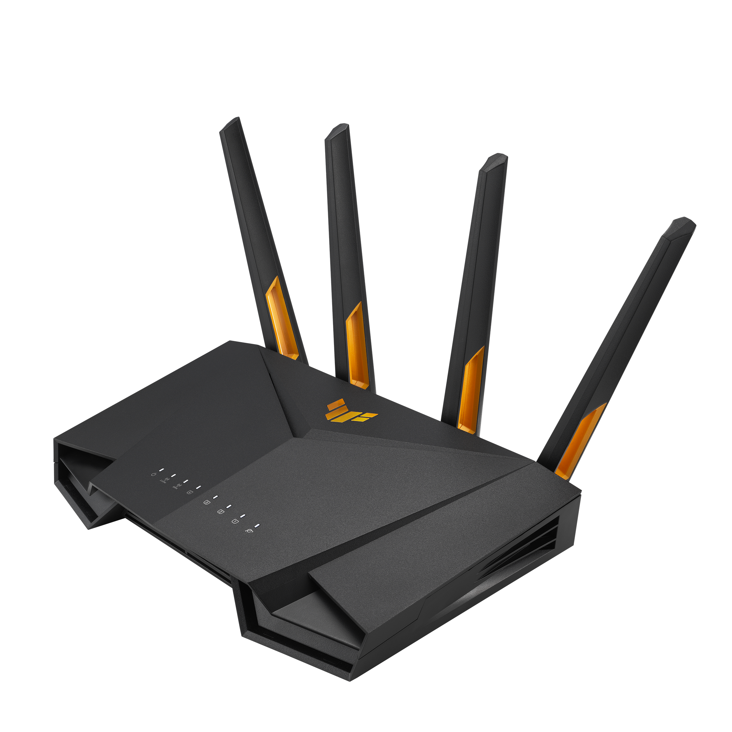

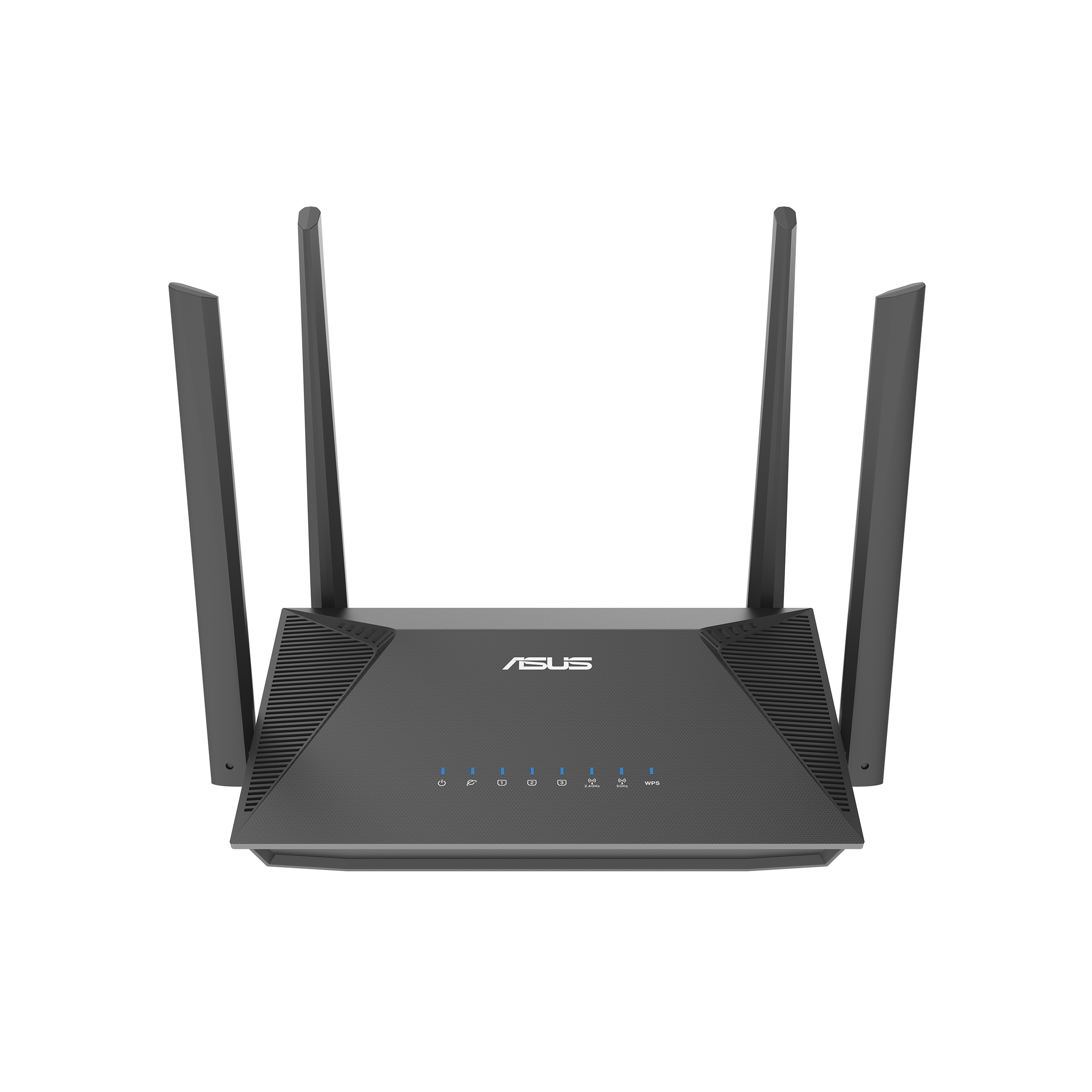

I don't know what main router you have, but forget about AiMesh. If you want a cheap Asus AP mode see new RT-AX52 - only £54,99.
If you have a bit more budget, you can see TUF-AX3000 v2, RT-AX59U or TUF-AX4200. However, for AP mode only, I wouldn't spend more than about £100.
